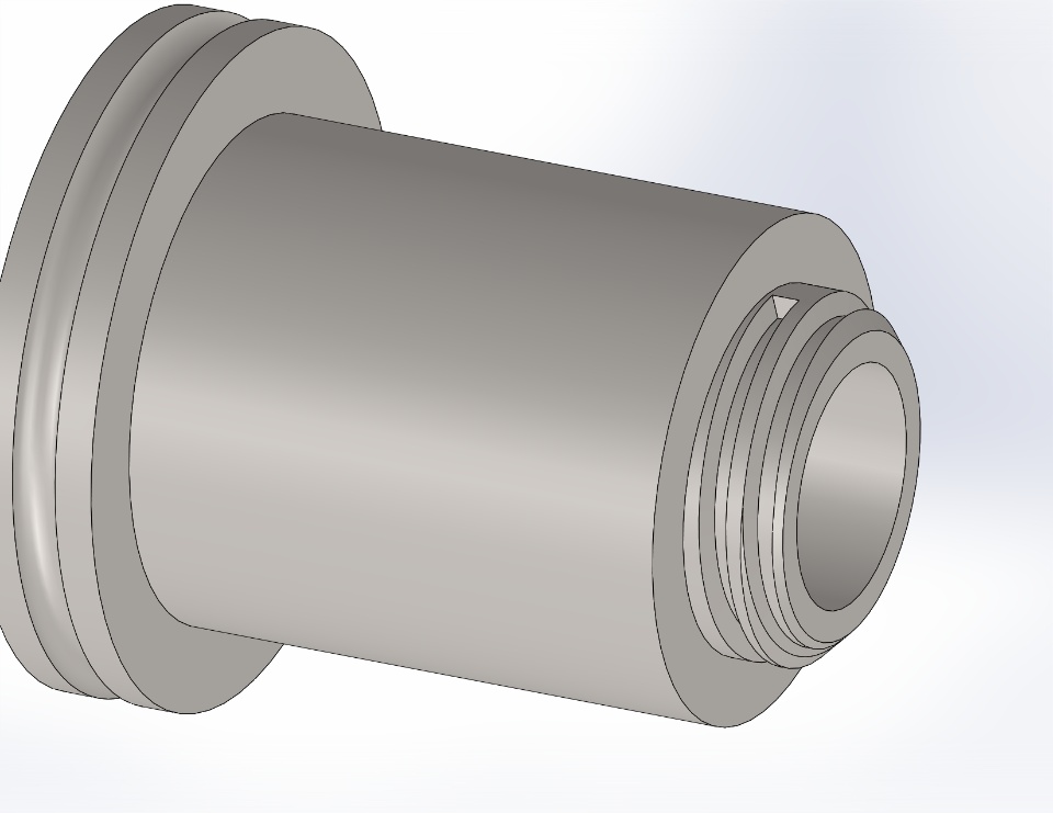

When I model acme threads or unc threads SW never seems to complete the thread. (see example)  If I continue the helix which is sweeping the cut, the profile will end up cutting into the rest of my part. I have always struggled with this and I need to know a correct way to do threads.

I almost never draw threads, but if you do it this way, you will need an additional feature to "clean out" the remaining part of the thread.
SOLIDWORKS is completing the swept feature exactly as expected, how you finish the thread is entirely up to you.
I would always work with a thread relief, then I could sweep the thread profile through the entire section and have finished threads.
(Basically the same way you would cut the threads on a lathe - you have to give room for tool clearance.)
ML
ML 2017-10-19
How is the part produced? Machined/ground or molded? SW doesn't make threads, it makes helical cuts, and you have to be able to figure out how to apply that geometrical feature to a functional design. A simple thing to do is put a revolved cut on that flat face. If you really want to sweep it, you can convert the helix to a 3D spline, then add a tail on the spline leads out of the part, just like a grinder would, but you have to be careful not to nick the main body (several ways to do that- you could just nick it and then use Delete Face to get rid of the nick, or you could make the threaded area a separate body from the main body and join bodies after cutting the thread, or you could make the main body a separate feature, and add it after the thread.)

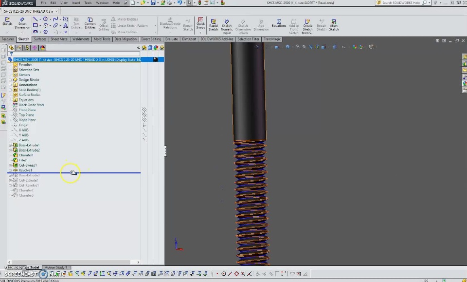

Hope this help - Tread lead-in / Lead-out​
DP
DP 2017-10-19
Honestly, in my opinion, just cut the thread past where you want to go and then just add a solid cylinder to the model with a taper at the end that is the same angle as the sidewall as the thread.
Although I agree with the others......why are you modeling threads?
See the attached video:
