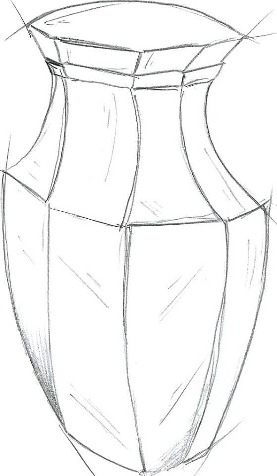

I am trying to model the attached image in solidworks and wondering if someone could explain the best way to do it? Its a clear glass vase, I will also need to fill the vase with liquid is there a good technique for this?
Hope you can help,  as a little stuck!

SM 2010-11-21 Best Answer
Alex,
Ok, are you looking for someone to give you instructions on how to do it?
Or wanting someone to do it for you and you see how they did it?
I personally on a quick thought would do a variable section sweep.
Meaning a couple of sketched sections at the points where the outside
form changes shape and guide curves at variable quadrant points
around the outside.  Regading the water, use the cavity command in the mold
tools toolbar and do a reverse then shave away what you dont need then
make it semi transparent.
I would create it for you, or something close, but really don't have time.
I hope this is enough to get you started.

Another method (for the outer shape of the vase) is to cut a profile from a cylinder, and then pattern that feature.
KL
KL 2010-11-21
For the liquid;
Use the Copy/Move Bodies function to create a copy of the first body, deselecting the Merge option to create two identical bodies.
Cut the copied body down to the level of the liquid.
Shell the original body using the Outward option.
Set appearances to suit.

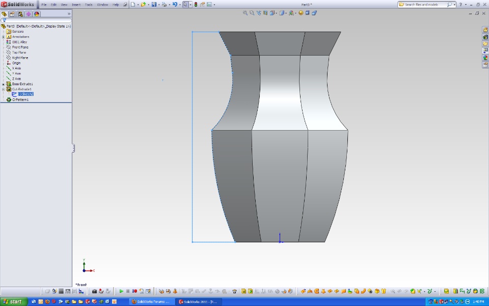

There are many ways to model this geometry. Attached is a method using the Swept Boss/Base feature. The combine feature was used to create the "volume" solid body. Hope this helps.
SF
SF 2010-11-21
Bill you beat me to the sweep extrude. Your method looks overly complicated,a simple shell with a variable thickness for the bottom of the vise would work with far fewer steps.
Will demo later today since have to go fix a leak in my daughters house.  smile
SF
SF 2010-11-21
Yeah.....I tend to do that . I'm interested to see your approach. Good luck with the leak.
SF
SF 2010-11-22
Ok here we go.
Took your sketch and mirror copied it on the front plane and then copied it to the right plane to make guide curves.
Made a new plane on the top of the vase and then copied the octagon there.
Sweep from the bottom to the top and then selected the guide curves.
Makes a solid.
Select the top of the vase and do a shell. (If you just say shell you get a hollowed out solid)  Activate the Multi-thickness settings option and click the bottom of the vase.  I did .5 just for fun.  To see it look at it in "hidden lines visible."

Here's another approach.
MD
MD 2010-11-23
Hubert,
Why does the vase show some of the faces "merged" and others with defined edges?
This is not the normal sort of part I would do so it only a thirst for knowledge.,
Thanks
Michael
comment imagecomment image
SF
SF 2010-11-23
Haven't a clue.  I did notice if you look straight down on the vase some of the sides are curved while others are straight.
BUT went back and did it even simpler with only TWO FEATURES:
- Boss Extrude with guide curves
- Shell
Take a look.
