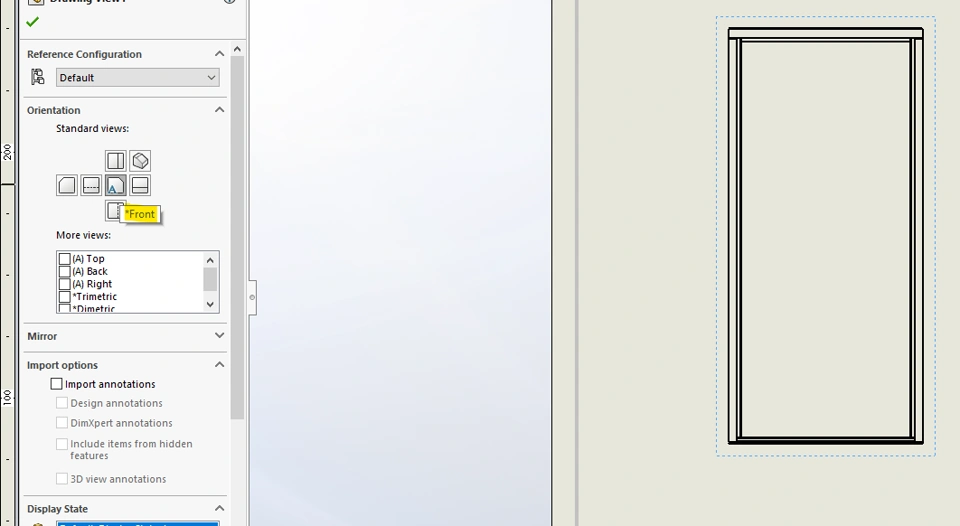

I'm working on a project where i will automate the dimensioning for some 2d drawings.

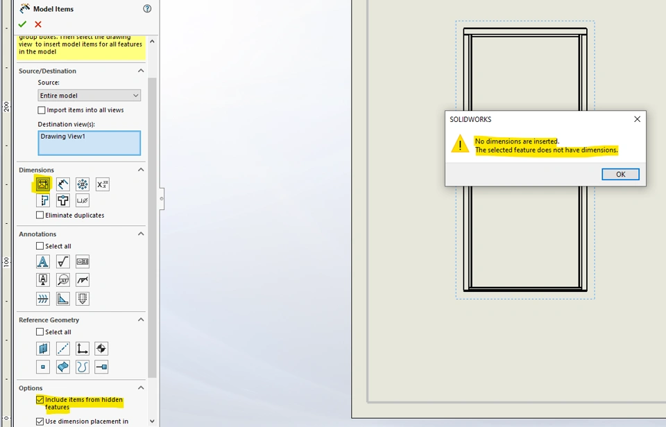

But for some of my dimensions i have a hard time getting them into 2d drawings using feture "Model Items".
Some notes below:

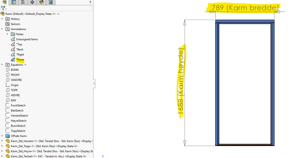

  • The dimensions i want is for sure "Marked for drawing" and i parallel to the view.
  • The dimensions is driven dimensions, but i have tried to make them driving as vell with no success.
  • I'm making these dimensions on top level assembly, and I'm using sketches to plase them. this is because i need controll over the dimension lines.
Take a look at pictures.
Can anyone please tell me what I'm missing here?
Thanks in advance 😃

I think you may want to try using annotation views as an import method instead. It will give you greater control. In your second screenshot, notice the 'more views' section with (A) next to some of the views. These correspond with the annotation views you have expanded in the assembly. If you tick the box for the annotation view you want, followed by 'import annotations' and 'design annotations' it will bring in any annotations assigned to that view. I have a feeling that the dimensions you have added are reference dimensions based on the colour, so I don't think model items will import them with those settings.

back in the day I was making parts that were round with a revolve cut thru the middle.   Special geometry for the out side and inside.  To get all the dimensions to show up I would put the main revolve on the front plane, then I would have to do my second cut on the right plane, for the internal cuts.  It could have been done in one big sketch, but to edit the sketch was a pain when you needed to modify the inside or outside so making two features worked better.  It also allowed all the dimensions to be inserted into the drawing.       Before adding the unnecessary features review your system options, and document properties.  Also try to bring in the dimensions not marked for drawing to see if they show up.  This has been where some of the dimensions I am looking for show up.

Your dimensions could all be "marked" for import if you have this setting enabled that I highlighted in the screenshot.
I believe you'd have to manually unmark all of them. Another screenshot to show that.
