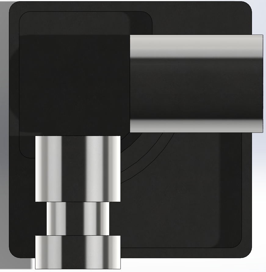

I am not sure my does my model in top view show shiny dark color which is misleading to me... I am not able to view dimensions and sketches clearly while editing in top view.....

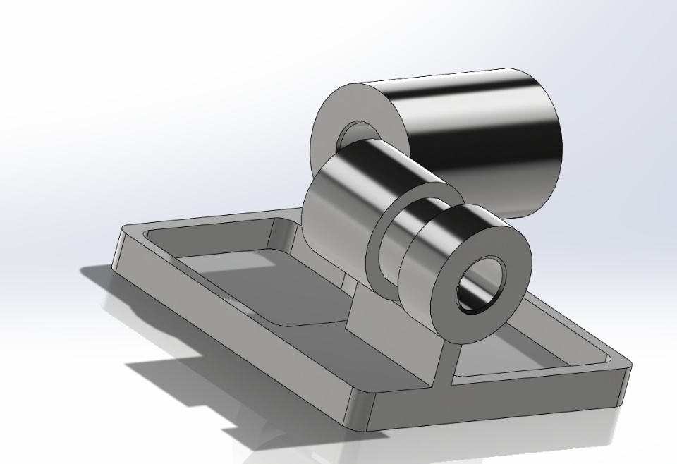

I just need to see the part clearly.....atleast like attachment 2. I did not have this problem in previous version of SW.
I tried to make some changes in "System Options->Model Display...but that disnt help

Turn off the Ambient Occlusion if you do not like it. That is new in SW 2012.
http://help.solidworks.com/2012/English/solidworks/sldworks/t_ambient_occlusion.htm
It was actually "Real View Graphics" which was automatically turned on after I installed 2012. This is just below the "Ambient Occlusion".
I didnt know about that as well.... thanks for that.... Now its perfect ..thanks
