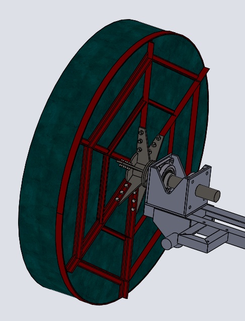

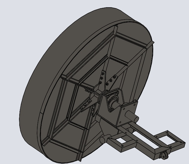

Hi i'm a little bit frustrated about this Model display color, i tried to change everything in the color option and also i reset my registry but still i does not fix my problem
If i open the model it shows the color or appearance that i specify but after editing one of its component it turns the entire assembly into dumb grey color. But if i will close and open again it will show the color i specified but after editing a component it will turn again the entire model into a Zombie color,
Dell Precision M6700 with Nvidia Quadro K5000M
This is also not large assembly it only contains 98 parts
Zombie color
The human color

Yeah you are correct the material assign from the shaft jump to the entire assembly overriding everything as John Stoltzfus​ pointed in the color overrides picture. here is my recording
