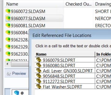

I have an assembly that has a missing file reference until I open it in Solidworks. Once the file is open the file shows up and the reference. Has anyone else encountered this?

comment imagecomment image

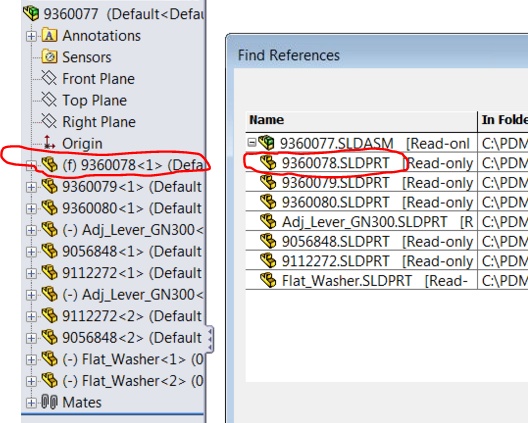

After working with my VAR and SW this is caused by a bug in SW. Here is the sequence of events that causes it to happen.
1. Open a file from an assembly.
2. Make it dirty (Make SW think it has changed.) The * will show up by the file name at top of the page.
3. Close the file.
4. When prompted to save say no.
5. When asked if you would like to discard changes in the assembly select discard changes.
6. Under File/Find references the part that was opened is missing.
A rebuild or save makes no difference the file is only restored if you reopen it. If the assembly is checked in the reference will be missing in EPDM. Has anyone else seen this? Seems like this could cause problems for more than just us.
The SPR# for this is 744970.
