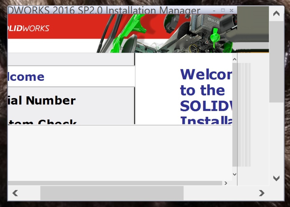

Does anyone else have this issue with 2016 Installation Manager SP2.0?  Trying to install a student version on windows 10 64bit and this keeps coming up:
Links do not work and cannot maximize window.

Ryan, I guess it would be a good start to change some of the screen resolution and scaling options you have in Windows. You may have a 4K monitor and have set scaling to say 150% so try 100% (via desktop right click and Personalize) and see if you get any joy.

Hello Adam,
I do have a 4k monitor but changing the scale to 100% did not work.

Ryan, this may help. The application your launch to run the Install Manager should be called setup.exe. See if you can find this on your system. If so right click and choose Properties, and then tick this box and re-launch:
comment imagecomment image

Hello Adam,
It worked!  Thank you so much for your assistance.  Much appreciated!
