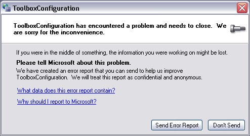

Completely reloaded SW from the disk. It did find the toolboxdatabase and updated it, but now when I try to do the configuretoolbox, it errors out and says it needs to close. Anyone else runinto this?

nope. I just got done unloading 09. Used the batch files fromSW to clean everything up. rebooted prior to reinstalling. Duringthe install it showed it as updating the toolbox database, with noerrors. After the install, rebooted again. Able to open SW. It doesnow show the company standard, but when I try to configure the holewizard/toolbox it errors out. see the picture.

Just a guess, but I'm assuming that you have the toolbox on anetwork location.. Do you have the correct perms to modifyit?
SF
SF 2008-11-11
Yes it is on a network. And yes I have the rights to it. Iactually called my VAR yesterday and they opened up an SR. Hethinks it may have something to do with .NET since it involves theaccess database. I will post the answer once I get one.
