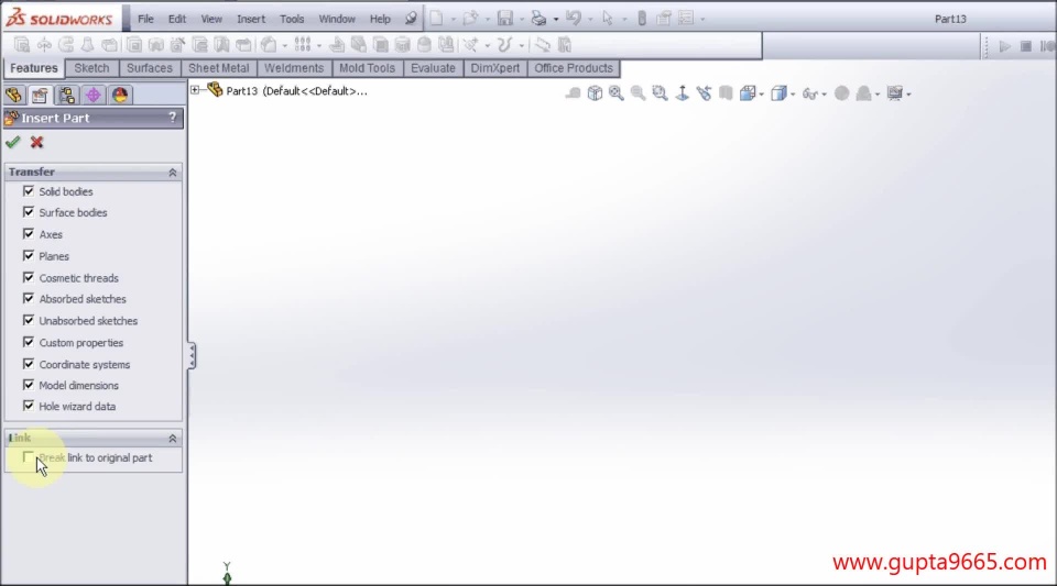

Are you creating mirror part using the option in a part: Insert > Mirror part.
If yes then while you do that you can check the option "Break link to original part" and the new mirrored part will be on its own.

As Deepak said: this is the proper method for doing this. Be aware that the mirrored part is created by taking the original parts and adding a move/copy body feature to create the mirrored geometry. All of the sketches will stay where they were. So even though you do have a mirrored part, the sketches don't show up on the bodies where you would expect them.

What you guys said makes sense and I was able to do that however what I am intending to do is to make the new mirrored part COMPLETELY unrelated to the original. I have mirrored the part and broken the link which is good so far but at the bottom of the new parts design tree is a "Body-Move/Copy1" command. If you delete or suppress this command the new part returns to the orginal version. It sounds like I am asking for a lot but for my purposes I am still considering this linked to the original which I am trying to avoid.

My previous company was looking for this same type of functionality and unfortunately there is no current method that is easy. The way we ended up doing it was to save the part as a new part and then edit each sketch and feature, flipping the dimensions or direction of extrude, until we had a part that was the same but a mirror image.

Just to add, you can also create a copy of the part and finally add a mirror feature to the part (while selecting the body in the mirror command). This will make a mirrored part
