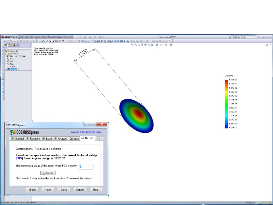

Minimum Thickness for Simulation Express?
I have a part which is simply a stainless steel cylindrical disc, 35 microns in thickness.
Using simulation express, I would liek to fix the edge of the disc, and apply a uniform pressure to one face.
Whenever I run the simulation, it tells me: Part 1 SimulationXpress study: Failed
I tried running a similar simulation with a thicker disc, and it works. Is there a minimum thickness in SimulationXpress?

Stephen,
It is all a matter of the ratio disc diameter versus thickness. SWexpress bases its element size on that ratio and tries at least 2 smaller element versions if the initial element doesn't give a good matrix. The attached disc is 30 mm diameter and 35 micron thickness. The load is 0,001 Newton on one surface and the restraint is the circular edge. As you can see it runs well in SWEpress even in SW 2008 version.
SW express needed 50598 elements in this case.
What diameter is the disc you are working on?
The preferred element size need to be app half thickness so 17 micron.
