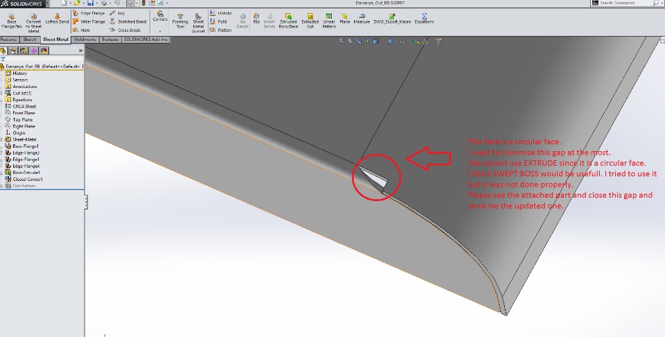

I want to minimize the gap for relief seen in the below image.
The face on which the gap lies is a circular face.
The gap should be closed such that there is no intersection in its flat-pattern.
Please help. I have attached the part herewith.

Can you build it like this ?
You can continue to do how you approached it, e.g. like this. See attached part, It flattens fine.
Or you could approach it differently e.g. do the side flanges last, with material inside.

Creating the Side Flanges at last won't work, see the below image.
The part you attached is good. However I was searching for some better solution if any.

Just an idea, but do you want me to find an alternative method creating your part ?
BS
BS 2015-10-29
I would be very thankful if you can do so.
Just one point - The geometry should remain as it is, no matter which features are used for it.

Bhavarth,
You asked this question months ago, but in case it's still of use to you here you go.  I made this model of your part today.  I like the unfold - cut technique for situations like this where we want to precisely control sheet metal edges.  If you want to use this model directly you will need to look over the numbers used, I made my model in Imperial units, not Metric.  Hope this is helpful.
