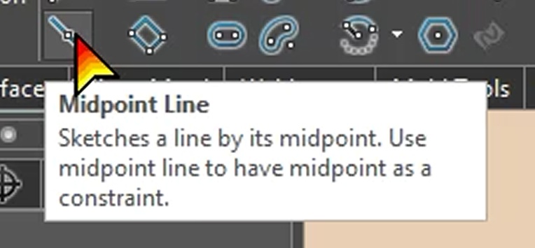

Midpoint Line
Do you use this line often what is your experience? I found usage of this line is very limited. Particularly if you are doing loft you can’t use this as construction line because it places an active point at the middle (inactive construction line with active point at the middle)  which can distorted the end result.

GS 2021-04-08 Best Answer
I was one of the people asking for it before it was available, but now I never use it.  Partly because my workflow changed so that I have less need for it, but mostly because I don't like the way it was implemented.  With "Enable numeric input on entity creation" turned on, the value entered is from the center point of the line to one end instead of the full length.  Apparently someone thought that was a good idea, but I disagree...vehemently.

This video shows construction line using it’s midpoint sketched in 2 ways:
1)Using coincident relation.
2)Using midpoint line.
Even though it looks same, but both are not same it may have an influence in the end result. Because of a point in the middle in the midpoint line.
SPR 822517: Ability to select the dimension type (half or total) during creation of the Midpoint Line
SPR 803075: Cursor feedback for midpoint line should be total length

Hello,
As I showed in you can use a midpoint line for creating a symmetric sketch for things such as Hole Wizard [oops, forgot that's there's a point at the middle, so for HW, the separate sketch workflow is required for this]:
But other than this, I don't see much utility with this entity.
