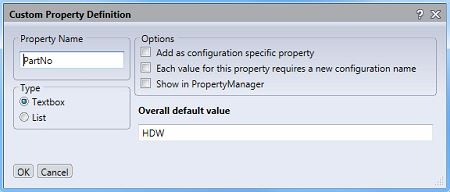

Using the Toolbox Configurator, I created all necessary custom properties we need (Material, PartNo, and StockSize).  StockSize and PartNo are not configuration-specific.  We don't give our hardware part numbers.  In our BOMs the PartNo column simply states "HDW" and the StockSize column "N/A."  Our custom manufactured components use those fields.

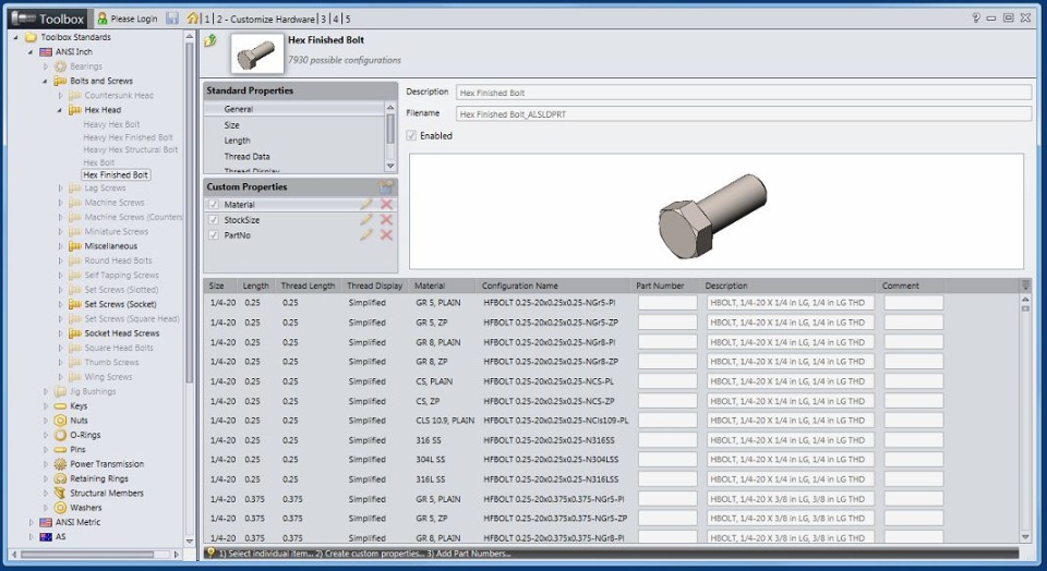

I exported the Toolbox data to an Excel spreadsheet, entered all the description information, then imported it back in.

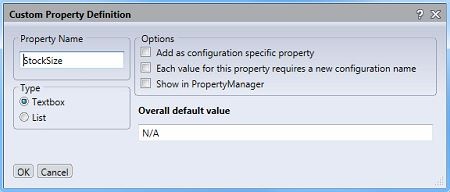

When I open a top-level assembly, it takes a few minutes while the Toolbox regenerates all the missing configurations.  But when I open the drawing BOM, some of the hardware entries for "StockSize" look like the descriptions but the sizes don't even match the parent (e.g. a 5/8-16 X 1 in LG bolt will have "HBOLT, 1/4-20 X 1/2 in LG, 1/2 in LG THD" as StockSize).  I open up "hex finished bolt_ai.sldprt" and some of the configurations now have a StockSize configuration-specific property!  Why???  Where is it pulling this information from?  Is it embedded in the top-level assembly?  And most important: How do I stop the Toolbox from creating this garbage?  If all the information required to generate new hardware configs is in the Toolbox Configuration tool, why is it adding nonsense that isn't there?  Look at the attached images.  The StockSize property does not have a single box checked in "Options" yet it's showing up in some of the configurations as a configuration-specific property.  Why???  Grrrrrr...
