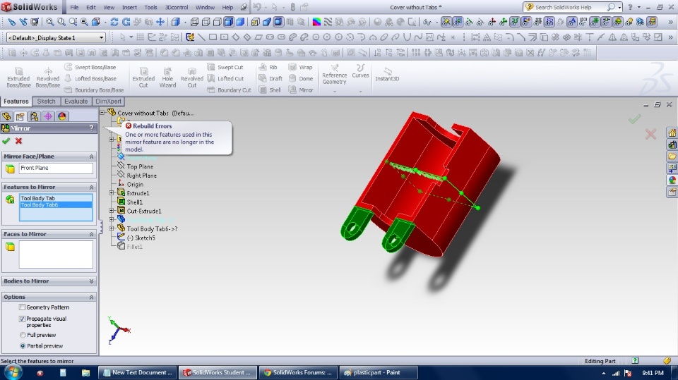

im going over a 2009 advanced model book i added some tabs to a body now im told to mirror the tabs when i do it gives me a error message( one or more features used in this mirror feature are no longer in the model) i can see them but the do have a  ? at the end of the features in the model tree. what can i do and what is the question mark about.

The question mark is because of the reason that you don’t have the tab part file opened up. If you open that file, the question marks will go away.
And for mirror issue, select the two tabs under bodies and not features.
