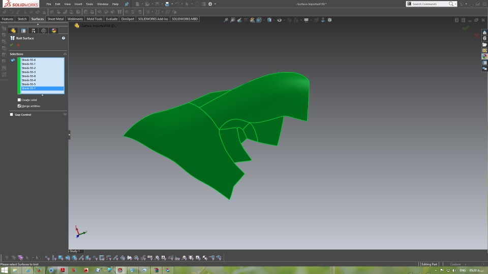

i have a part of surface an i have 35000 surface for kint i have remove split line cuse for easy select bundery edge
to
i now i can remove by show as phantom or dont show hidden  tangent line but i wont it
i want one surfece and without between line very important for me no be line between surface
haw i can do it ?

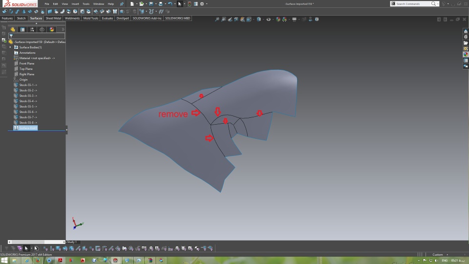

Hi thanks
i now i can remove by show as phantom or dont show or hidden  tangent line  , but i wont it
haw i can do it ?
AM
AM 2017-03-11
hi thanks
I NOW it  ===>>>   {{Switch to "Shaded" view rather than "shaded with edges".}}}
i want combine\kint  surface without tangent line like this pic
comment imagecomment image
AV
AV 2017-03-11
<p>Ali Mehraban wrote:</p><p></p><p>hi thanks</p><p>I NOW it ===>>> {{Switch to "Shaded" view rather than "shaded with edges".}}}</p><p></p><p>i want combine\kint surface without tangent line like this pic</p><p></p><p></p><p></p><p></p><p></p>
Asking to remove edges is akin to creating a new surface with a different geometry. Points belonging to each face are driven by the same math. Edges represent the boundary between areas with different math rules.
Sometimes you can remove faces that are contained inside other faces, like here:
http://www.javelin-tech.com/blog/2013/11/solidworks-tutorial-direct-modeling-patch-holes-existing-solids/#.WMQUNZHEif0
Other times, you can ask SW to extrapolate the available information to create new faces that would approximate the ones you want removed:
