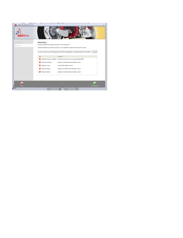

I have been using this computer for 3 years and it has worked fine for solidworks until I installed 2010.  Some times, seems more than less, when I attept to use the hole wizzard I get this error: " out of memory or other error trying to initialize data source from stands file" C:\\documents and settings\\mikef.ABPW\\application data\\solidworks 2010\\holewizzardfavorites.mdb""  Then I cannot use the hole wizzard.
I have been working with my VAR for over a month and we tried making sure I had read/write privilages, now they are saying the problem is with my system.  They are saying I need: Microsoft Data Access Components (MDAC) 2.8 SP1.  This file does not load up.  I'm at my witz end on this and am wondering 2 things.  1. does anyone know what may be going on, cause the VAR doesn't because it would be fix'd by now  2.I know my graphics card is not on the approved list and am thinking I am going to put a new one in that is approved.  Which one would be good?

Ask you VAR to check solution S-04716. Did they try that?

Thanks.  Yes we tried running that file.  Seemed to work at first, but didn't fix the problem.
