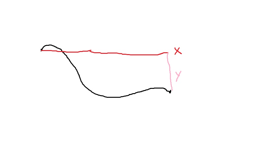

I attached a picture to show what I mean. I know you can do x y and z distance but is there a way to measure between to points on a curved surface (my specific cause is an airfoil and I am looking to measure the amount of air foil surface between the two points not the x y and z distances between the points.

You will need to create a curve on the surface and then measure the length of the curve.
