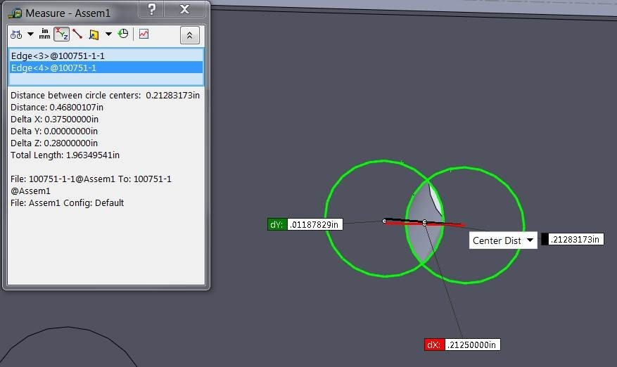

Measurement Tool inaccuracies?
My colleague ran into a new one this morning, note the measurement callout on the screen vs. the measurements shown in the table. So, which one is correct? Hmmm, never saw this one before ​, and ​.
He saved the part before I could delve into it further.

JW 2017-09-22 Best Answer
Hi Edward,
I can reproduce this too and I looked at our database and it is reported as SPR# 996535. Because these cases can be somewhat data specific, to make sure we understand and fix the whole problem, I would suggest reporting the issue to your reseller and include the data. Then they can attach this example case to SPR# 996535 for you for when our developers evaluate it.
Thanks,
Jim
EP
EP 2017-09-22
Thanks ​, will do!
