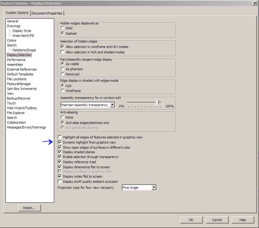

select dynamic highlight from graphic view, then the edges you want to select are shown

Pre-select your entities and then hit measure tool or better assign a keyboard shortcut to that.

option was already checked
it is still not giving me any preview

My dynamic highlight works fine with the measure dialog open.
