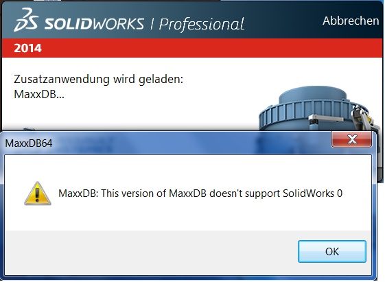

after installing SolidWorks 2014 and checked Version of MaxxDB to 3.03 SP00 i´m getting an error at startup "MaxxDB64: This version of MaxxDB doesn´t support SolidWorks 0".
There where no errors througt the installation of SolidWorks...
This issue is shown on all my SolidWorks-Clients.
I tried to un- and reinstall MAxxDB with current version (303sp000.exe) but nothing changed...
Nothing in Reg or any config-files (*.ini) is faulty...
Does anyone have an idea?
Thanks a lot for help.

Clean new/fresh installation of SolidWorks 2014 an MaxxDB 3.03 SP00 on a new Workstation...
Same error..
Could it be that the MaxxDB-Addin isn´t compatible with the new SolidWorks Edition (SP01)?????

Hi everybody,
after contacting the MaxxDBSoft-Support "Solidpro", they published a new Version off MaxxDB 3.04sp020 which is compatible with SolidWorks 2014 x64 SP1 `n 2...
(Link: http://www.solidpro.de/maxxdb3/ )
Problem solved.
