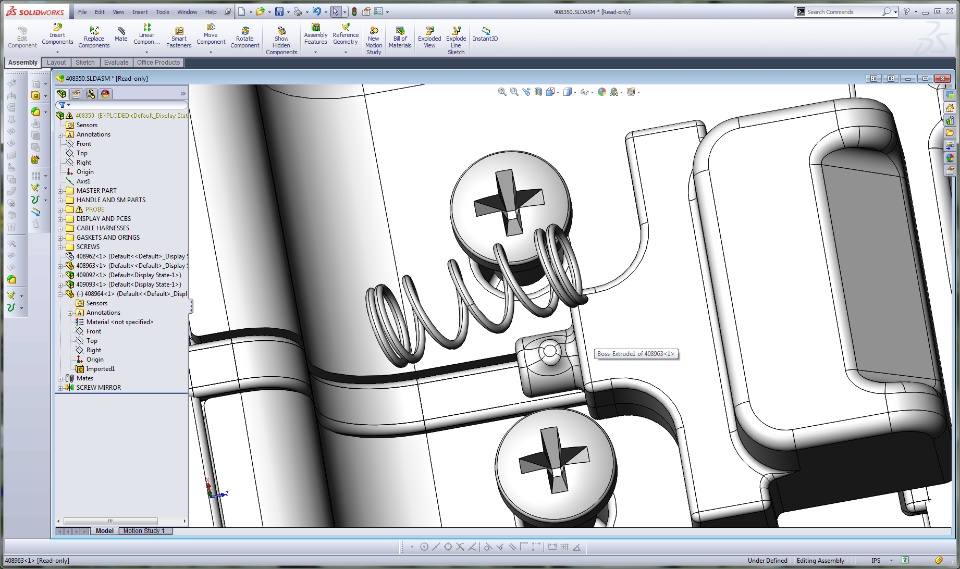

I seem to be spending way too much time trying to figure out how to mate odd shaped parts. I try all sorts of things to get things to stick together, and I was wondering why I am having so much trouble. The spring in the picture to me is impossible to mate to the little protrusion. The other part that would be on the left is invisible right now.

Use existing sketch entities and planes to mate the spring to that post. Or create sketch geometry, axis, planes, etc... that you feel would be needed to mate the parts together.

The simplest way to mate the spring to the protrusion may be as follows:   Beings your spring is round, and the protrusion is round, both will have a temporary axis. Display the temporary axes and mate the two together. Probably will mate automatically, but it should be a concentric mate. Then use the bottom plane of the spring, and mate to the flat face of the protrusion, using coincident, or distance mate. If you have no bottom plane, then make a slight flat spot on the bottom of the spring, like a ground end. Best wishes.

Yes, axis. That's the one I usually try last, but forgot today. Jesse had a good idea about using sketches too. I'll put a sketch point in the middle of a square post in order to center it in a round hole for instance. Thanks guys! My head's pretty gone dissolving and reassembling subassemblies all day. It was amazing the SW was keeping track of everything, and nothing crashed and burned.

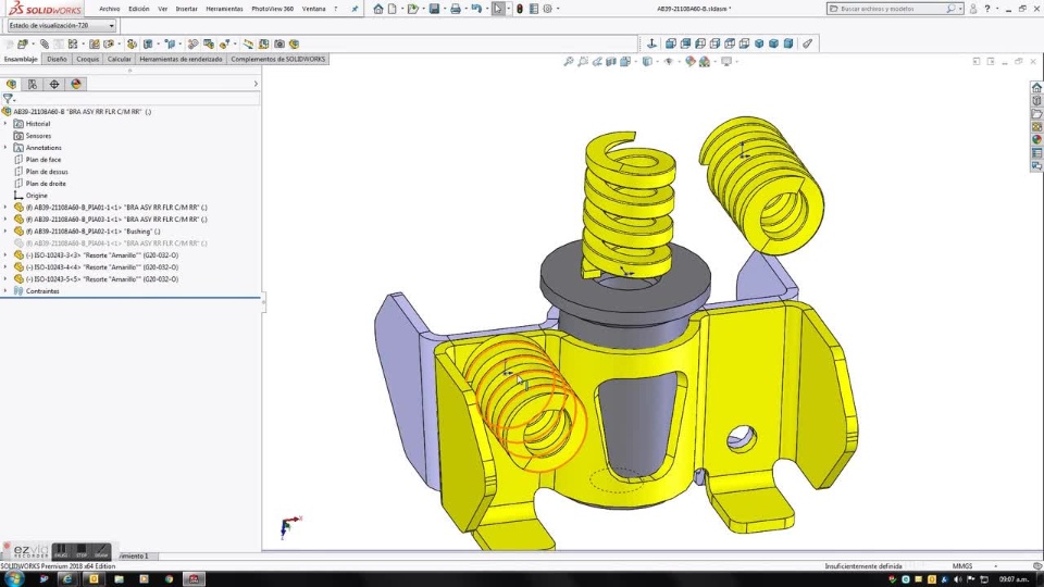

I'm Design a spring ISO 10243 Standard with DT and I have one posible solution....not the better but it's works fine to me...
The solution was made a extruded cilinder and on this one add a automatic relation of position
When you add this one you only try to find any cilinder hole or wherever.....and thats all I will try to add a video file
