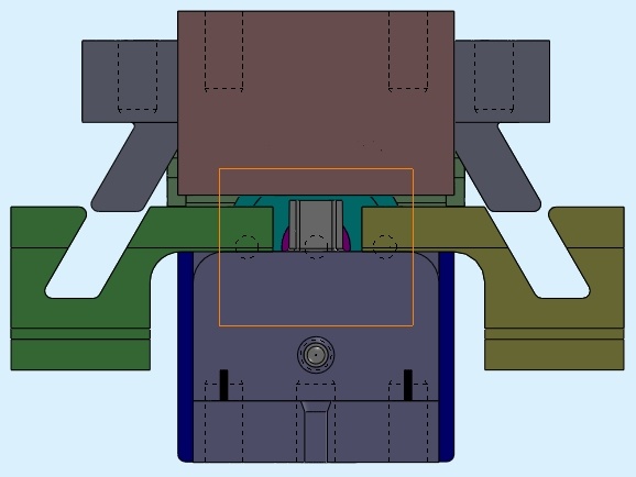

I have an assembly for a mold that has two slides that are moved in both directions by another sliding member. If you look at the picture I uploaded you can see a yellow and a green sliding part that get pushed in and pulled out when the top sliding part engages the 30 degree slot. How would you mate this so when I move the top block up or down the green and yellow parts are moved too? I looked at the Mechanical mates and didn't think any of those would work. Tried the "Linear/Linear Coupler" mate in advanced mate but I always got an error saying that mate would over define my model. Any ideas are greatly welcomed.

The first thing that comes to my mind then is a path mate.  Maybe a sketch in each slide part that has a point tied to a sketch line in the top part.

Can a path be more that one line? Say a vertical line to the top plane of the slide and then an angled line on the centerline of the slot? I have not used the path mate yet.
SF
SF 2011-06-21
Should be able to - here is the relevant statement from the help file.
"For Path Selection, select contiguous curves, edges, and sketch entities. To facilitate selection, click SelectionManager."
