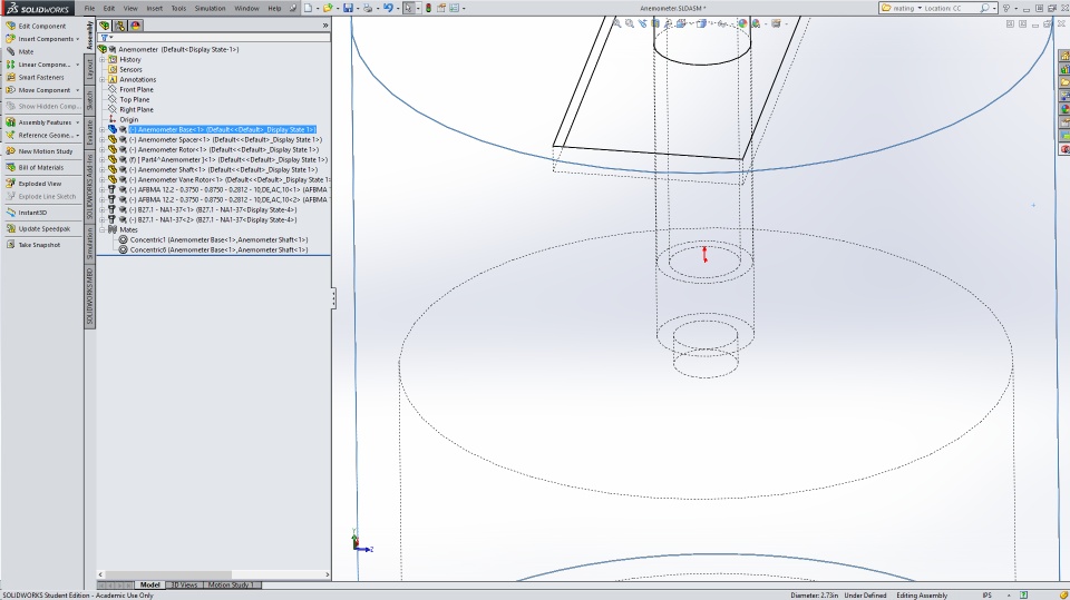

I don't know if this answers your question, but I usually mate parts using one of the top two drop down choices in the Display Style shown in the picture below. I can click down in the outer piece to select that face, and the face that is the bottom of the inner shaft. Also a concentric mate to put the shaft in the middle.
comment imagecomment image

SF 2015-09-09
Genius! (on your part...no so much on mine)  I got it.
