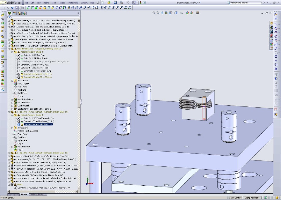

I have a block with two holes in it, and in the assembly two pins are mated concentric with these holes.  When I change the hole location, the pins don't move to the new location, and the mate shows an error.  I rebuild and the mate doesn't fix itself.  I suppress and unsuppress the mate, and it doesn't fix itself.  I can even drag the pin to the hole and it snaps into position, but still the mate shows an error.  The only way to get rid of the error is to delete the mate and create a new one.
What is going on here?  Running SW 2010 SP4.0.  I don't have time for this!

Sure, here's a screen shot, but I don't think it'll help.
Trust me, there are NO conflicting mates.  The pin (highlighted in the screen shot) should be concentric with the sheave around it and with the hole in the block, and its end should be sitting on the table top. And everything was hunky dory until I moved the hole in the block.  This has happened at least twice, with both pins.

So, you just moved the holes, using the same method to make them, just moving the circle in the sketch, for example? No draft change? No change of plane for the sketch, or direction of the cut?

Jerry, I'm moving the holes by editing dimensions.  No draft change. No change of plane for the sketch, or direction of the cut.
I rebooted this morning (before reading your suggestion).  I moved the holes once and the mates were OK. Moved them again and the mates failed.
Scott, I created everything.  There are no smart mates or other references.
(Few minutes later) I deleted one of my two pins, built a new pin part, and inserted it in the assembly.  Added the necessary mates, and the concentric mate for the remaining original pin fixed itself.
Then I moved the holes again, and the mates on both pins went bad again.  This is nuts.  Solidworks should be able to cope with this basic stuff.

in my experience, the mates that show the errors/warnings are rarely the ones causing the problem.
you do too have at least one external reference in the block part the pins are mated to, though that would not be the first place I would look. I would look at the mates for the sheaves and the block to see if there is some "overlap" in the degrees of freedom constrained.
