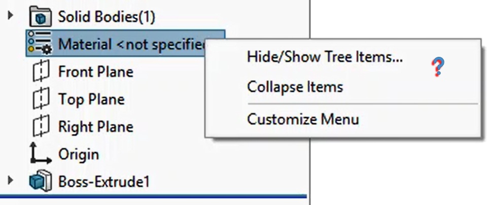

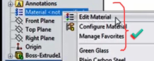

Some drop down menu option of Material feature in my FM design tree suddenly disappeared. How to bring it back?

If you right-click the Material in the FM, is the Edit Material checked so that is shows? Other than that, make sure you aren't editing something while trying to change the material.

Below is what I get when right-clicking on a blank part of the tree instead of directly on an item.  It looks very similar to what you're showing.  Have you tried several times and keep getting the same thing?  And if you click on something other than material do you get the correct options?  Have you tried re-booting your computer since this started?

Have you tried several times and keep getting the same thing?      Yes
you click on something other than material do you get the correct options?     Question is not clear to me
Have you tried re-booting your computer since this started?      I am going to try re-booting

<p>Maha Nadarasa wrote:</p><p style="padding: 0px; min-height: 8pt;"></p><p><span style="color: #333333; font-family: Verdana, 'Verdana Ref', Geneva, Tahoma, sans-serif; font-size: 14px;"><span>you click on something other than material do you get the correct options? Question is not clear to me  <span style="color: #2873ee;">I meant when you click on something else in the tree, like Annotations or Equations, do you have the same problem?</span></span></span></p><p style="padding: 0px; min-height: 8pt;"></p><p></p>

Are you inside another contextual menu?
What I mean is that, as an example, if I am currently in the middle of a measure command and I RMB on the material, then option for configuring material does not come up.
Are you in the middle of another command?  Maybe the window for the other command is off screen or behind the Main Solidworks window?

Thanks.
After re-booting the computer it restored.
