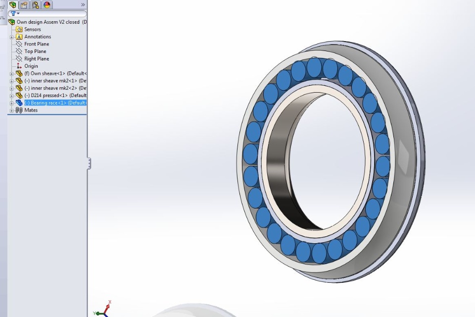

im trying to add a mate to the "bearing" in my part attached. Problem im having is that i cant seem to make a concentric mate for all these loose roller bearings to the shaft. Also added a Jpeg encase it doesnt open.

I think you need a tangent mate and not a concentric mate!

Hi Andy,
See the attached files. I added a sketch circle to be used for creating the concentric mate. It's generally best to avoid tangent mates as much as possible. They take longer to compute and have a tendency of flipping to the wrong side of whatever they are mated to.

arrrr so simple, i missed that! yes the tangent just wasnt working for me! Thank you
