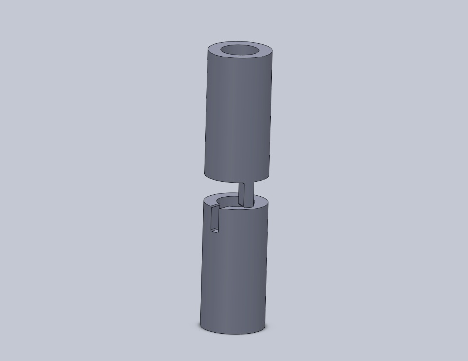

I'm working on a locking hinge similar to the model I've made here. I've given it Concentric and LimitDistance mates, but don't know how to create a mate that will stop the upper tongue from passing through the body of the lower portion, unless I create a Coincident mate, between the edge of the tongue and the top surface of the lower part, which then won't let it drop into the groove.
I've played around with Collision Detection, but it is slow and doesn't seem to want to work even when I leave a lot of clearance.
Any suggestions?

You should try path mate.

Would that mean creating a 3d sketch of the rotational and vertial motion?
The only problem with that is that the upper portion would automatically follow one path, when in reality there's nothing forcing it to drop down into the groove as it rotates. I was hoping to be able to constrain the motion to what is physically possible.

<p><span style="font-size: 10pt;">Would that mean creating a 3d sketch of the rotational and vertial motion?</span></p>
Yes
<p>I was hoping to be able to constrain the motion to what is physically possible.</p>
I don't think that an be achieved using mates.
Based on your final needs check 3d contacts under Basic Motion or Motion Simulation.
