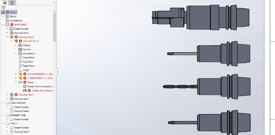

Here is what I am trying to do. I am creating a setup sheet for the machine shop with all the listing of tool holders, tools, and offsets. I have written a macro that does the following operation:
1- opens an Excel spreadsheet (contains all the holder, tool & offset values)
2- Search and open the holder for station 1
3- Search and open the tool for station 1
4- Creates a new assembly
5- Inserts the holder and tool in the assembly
6- Creates a concentric and a distance mate in the assembly. Save the assembly
7- Insert the assembly into the drawing
8- Repeat steps 2 to 7 for all the stations in the spreadsheet.
Everything is working but a lot of time the mate distance goes into error mode after more assemblies are inserted into the drawing.
As you can see above, assemblies 2 and 3 have errors in it. To fix that error, I open the assembly, re-define the distance mate. Just by opening up the distance mate, the error goes away. I don't change anything. Close the mate, save and close the assembly file and the error goes away. This is the code for the distance mate creation.

My thinking is that once I go to station 2, creating the new concentric and distance mate for that station affects the first. Any thoughts?
