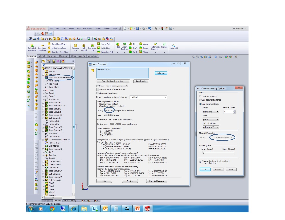

Hi guys,
Strange things happen to me. Mo mater how I assign the different material, but mass property report always tell me the same mass as steel density. from Mass Properties-> options I can see the density has been changed to the assigned material. but from the report, it still gives me the same density and the same mass.
How can I get the right mass?

DG
DG 2013-10-28
As stated, you've material applied to the body which overwrite the material applied to the part. remove the material from the body and you should be fine.

SF
SF 2013-10-28
Hi Deepak,
Why I can't see what you show me? from the picture I showed you, I didn't find Solid Body( sweep2).
Even though I supress the sweep2 feature, it still doesn't change the density .
DG
DG 2013-10-28
Make sure solid bodies is set to how under Tools > Options > System Options > FeatureManager > Hide/Show Tree Items.
This will let you see the solid body folder and then you can expand that and remove the material.
SF
SF 2013-11-06
Thanks Deepak. I got it.
