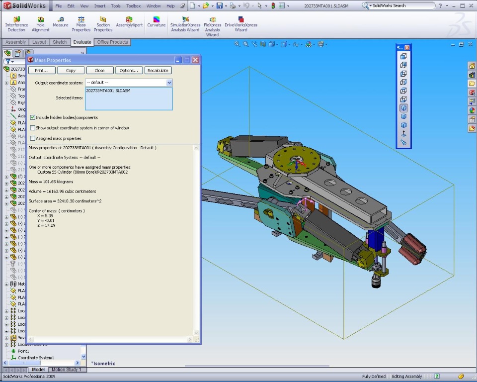

Is there a known problem with 2009 and calculating mass,CofG, and Moments of Inertia for assemblies?
In 2008 I could, thru the mass properties tab, display all theinformation for the entire asembly. In 2009 it will only calculatethese properties on an individual basis.
Whats going on? This was an important and highly used feature inour company.SolidworksAssemblies

Would the fact that the file was created in 2008 and containsmultiple sub assemblies?
I have tried several times clearing the "selected items" box andselecting all the components in the assembly. Still does not work?
See attached.

I must be mising something - it appears to display info. Isit not correct? I see that you have some assigned mass properties -is that a factor here?
WT
SF
SF 2009-01-28
The information displayed is correct however it does notdisplay all the information i need, specifically the moments ofinertia.
This is the info displayed of the complete assy.:
Mass properties of 202733MTA001 ( Assembly Configuration - Default)
Output coordinate System: -- default --
One or more components have assigned mass properties:
Custom SS Cylinder (80mm Bore)@202733MTA002
Mass = 101.65 kilograms
Volume = 16163.95 cubic centimeters
Surface area = 32410.30 centimeters^2
Center of mass: ( centimeters )
X = 5.39
Y = -0.01
Z = 17.29

I get this if I have assigned mass properties to anycomponents. Since you can't assign moment of inertia properties tothe component, it can't calculate that value for the entireassembly. If the geometry of the component with assigned mass propsis correct and complete, you could fiddle with the density of thatcomponent (instead off assigning a mass) until you get a correctmass, and then you'd have calculated moments for everything.
SF
SF 2009-01-28
That was it!!!
Stupid assigned mass properties!!
Thanks all!
