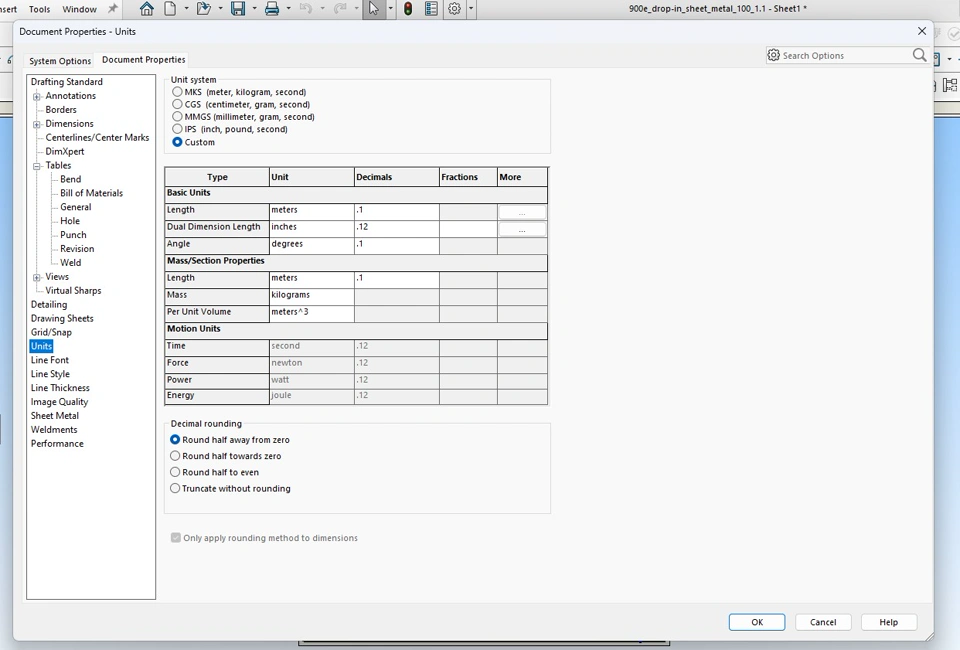

Trying to set mass properties decimal to 1, but box is greyed out. Seen a post from 12 years ago that had the same problem, and answers said to set properties to custom. I've done that, but still to no avail. Any opinions or solutions? Solidworks 2025 - SP1 if that's relevant.

Mass properties use the same decimals settings as length.
