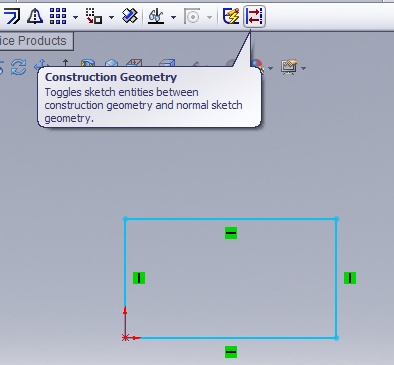

Not sure for the reason as I don't have SW2k10.
Try converting them using the Construction Geometry button.
If the icon is not there on the toolbar, go to Tools > Customize or right click on nay toolbar and select customize. Go to command tab and select sketch from the list. Now drag and drop the Construction Geometry icon on the sketch toolbar.

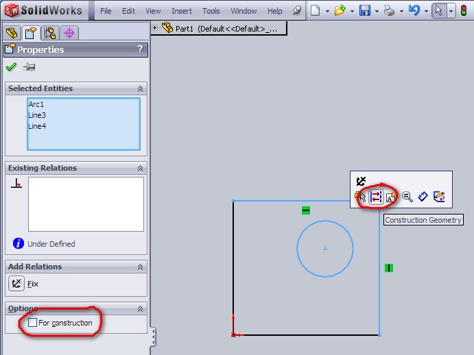

Either Ctrl select the entities, or crossing-box select (right to left drag), and then select either option circled in red.
The pop-up context menu should only disappear when moving the mouse away from it.

The option to the left that you circled, is the one that dissapears for me. Are you running the latest update?,
Does it stay put for you when you mouse over it?

Absolutely! It remains until I click in the graphics area, or click the green checkmark.
Which disappears ... the For Construction option, or the whole panel?
Are you using an approved video card and driver?
