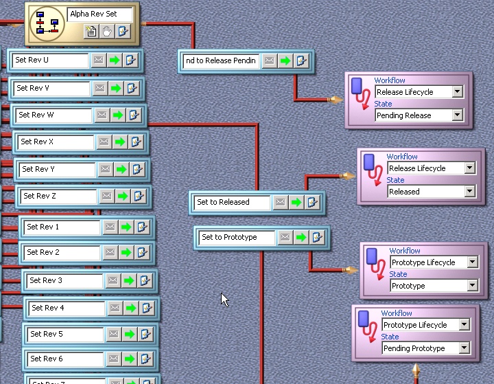

Is there any way to manually tell EPDM what you want to next revision of a file to be? Specifically when we redraw a part from our old system we would like to just bump the revision up a level instead of starting over at A.0. Is there any way to do this?SolidworksSolidworks Pdm enterprise Pdm
Answers 12
SF
SF 2010-01-04 Best Answer
I'm sure there is an API way to do this, but I've never messed with that. I setup at "Set Rev" workflow. Make a link from your default workflow to this "set rev".
You would have a transition for each rev A thru Z or whatever. Inside that transition set the rev variable, and then it goes back to the original workflow, at the proper rev and state.
see attached screenshot

I just wound up going with the workflow path. That way I could start the redraw at whatever rev level I wanted. Thanks though.
