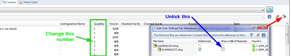

Hi,
I have managed to add & remove Custom references with the interface "IEdmEnumeratorCustomReference5". However I can not determine how I can control the Quanity or the function that adds the reference to the BOM side of things.
