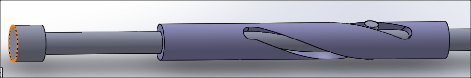

making functional spiral slots on a cylinder or how to mate with slots not created as slots
I have an assembly of two concentric shafts. The outer shaft has 2 spiral slots cut into it lengthwise and which exactly mirror each other .  The inner shaft has
a pin which fits into the two slots radially. Hence, moving the outer shaft causes it to rotate about the pin. See attached screenshot. The slots could not be created
as linear or arc slots and hence SW does not allow slot mating with the pin. I kind of followed  this youtube video using a wrap/swept cut  SOLIDWORKS - Swept Cut on a Cylinder - YouTube .
Since the slot was not defined as a slot in its creation, no slot mates are possible so I created a tangent between the pin and the "slot" wall. This works sort of.
There are several levers and connectors (not shown) which effect the linear movement of the inner rod which via the pin causes the outer rod to rotate
. If I move the outer rod it moves, the pin moves and the mechanical precursor  linkages all move. However as I move connectors increasingly far from the pin the linkages
sometimes work and sometimes don't. Probably 50% of the time they appear to lock and 50% they appropriately move the inner rod to cause the outer rod
to rotate.
I had thought my PC was too gutless but this is a small assembly of maybe 20 parts.
I think the tangent is a poor way to move the outer rod and wondered if there is any way to create genuine spiral slots to mate with the pin such that
the movement of the inner rod causes the pin to rotate the outer rod via the spiral slot.
I think this approach is FAR superior to mine Straight to Helix transition cut - Slot in Cylinder - YouTube
But even then I doubt the slot mates will recognise this as a real slot and I will be left with using tangent again.
Thanks for any help.

SS 2015-07-31 Best Answer
Hi David,
Have you tried the path mate option?
Just create this mate between a point on the pin and a helix that describe the slot.
Regards,
Sindre

Another option might be to create a surface body along the centerline (similar to Sindre's helix idea if it's not a simple path), and then mate a point on the pin to the surface.   (There is a youtube video someone else pointed me to that I often refer to based on path mating a chain just because I don't do it often and forget how ;-))

Hi Thanks for the help people have given.
I have used 3D sketch to apply a helix as suggested and used a path mate which appears to work better. I actually extended the tube and
applied a helix. then cut it to the length required so that the amount of rotation met what I needed (less than the 360 deg the full  helix involves.)
However the freedom/smoothness of movement appears to be determined by how far the moved part is from the slot.
From this video
omavor-yahoo
You can see that the tube rotates well when it is grasped close to the part, but becomes increasingly less smooth as I move to earlier
parts in the chain of mechanical links.
In the last part I suppress the slotted tube and all mechanial linkages work smoothly.
Appreciate any insight into this.i

One thing that I have done to make things smoother is to insert an empty part with just a reference point (or plane or axis, whichever works better for you).  Then mate the path on my spiral doohickey with the reference point on the empty part.  THEN mate the empty part to my sliding part.
It seems to work better for some reason.  I think it has to do with the processing between mates.  Each mate is processed separately (I think), and it is much smoother.
