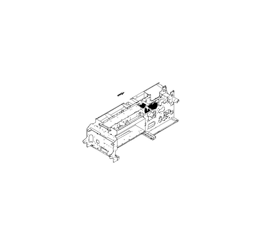

I want to make a block of a drawing view. Not just of a sketch.
Now I export the drawing to DXF, import to new sheet and then make block. Then I use the block as a surrounding to pin point a location in the hole machine or machine lay-out.
Inserting the complete view connects the complete 3D assembly to the drawing which is just a small part of the total assembly. The drawing is in that case to heavy to handle.
So just a pic of the machine is enough to make clear  of the location where the parts are mounted.
Is it possible to make a block of a drawing view or convert a drawing view to a sketch of some kind.

I have a big assembly, make a drawing with one isometric view. This view I want to use as a thumbnail like thingie in another drawing.
I now select the view, copy to DWGeditor, paste and save in DWG editor. Open dwg in SW and make block from the new sketch. Then drag block to the other drawing.
Specially the time needed to make a block of the DWG sketch, huge amount of lines, arcs and so on, is nerving.

When you select a face in an isometric view (see a view posts before) all the outlines of that face will be converted. That is not what I need. I need the lines as shown in the view and not the outline of the part as part. Same happens when you select just a line or arc. Faces of cilinders are not possible with convert entities.
