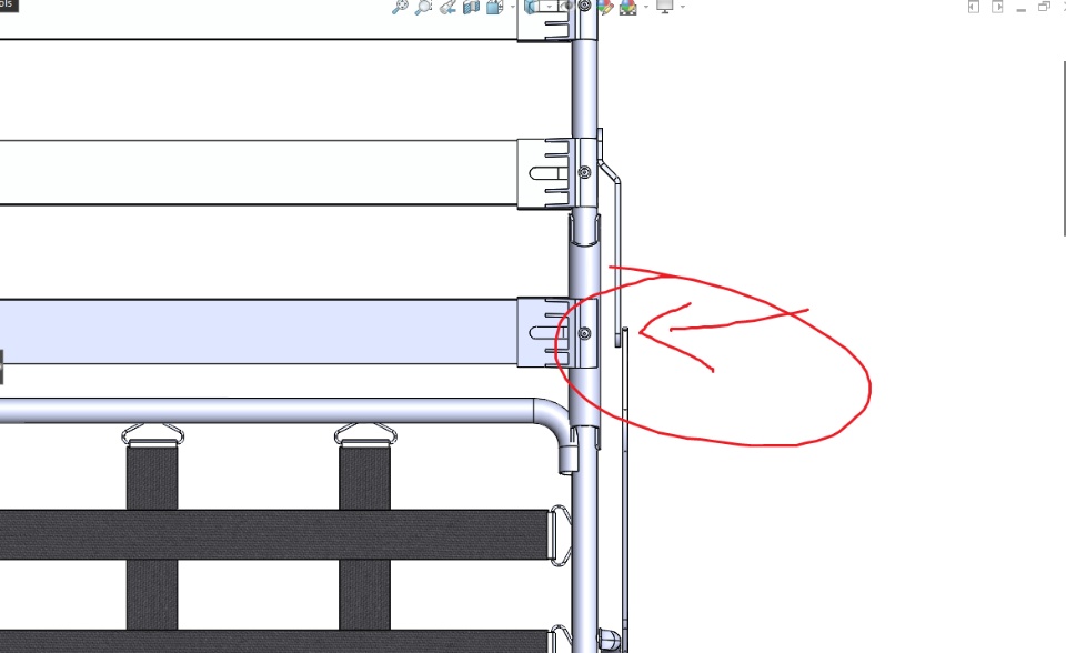

I design sofa beds and one of my my bigegst problems doing so is transforming what happens in reality to SW.
You can see on the attached picture that the part shown on the PrtSc with the 3 circles isnt flat with the sofa structure.
I want it to be able to twist like it does in reality. I've been experimenting with coincident mates: using mid centered points on the holes of this part and making them coincident with an axis on the other parts.. But it doesnt twist like it does on the picture!
Is this possible? thank you

it looks like you are trying to bend these parts into position with mates. this is not possible. you would need to design the parts already bent in order to match what it looks like in reality.
additionally, bending those parts into position in reality puts a lot of stress on the pin that holds the two to the frame and eventually the head of the pin will shear off.

No, I'm not trying to bend the part.. I know how to bend parts. (If you look closer I have a few).. But this part is just riveted at an angle wich I cannot measure and that angle is maintained during the opening and closing of the sofa bed.
