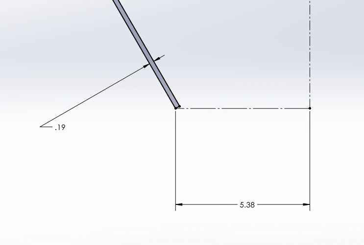

This is a Revolve feature that got split into 2 with the split command.
I'm drawing a blank to make this shape into sheet metal to flat pattern it. Do I have to remove the .188 thickness profile and leave it just a single line?

Use the "Insert Bends" feature and select one of the conical edges as the input. If it is a true revolved cone with a contant material thickness, it should convert to a sheetmetal object with a flat pattern.
Always, if your making a sheet metal part, use the sheet metal tools. The lofted bend tool will easily make this part and you can tell it to make it as a rolled part or as a bent part, like a bump-break. Material thickness does not matter.
I'm getting multiple bends, could this be reduced?
Alex,
Lofted bends is the solution. You need to pick BENT or FORMED at the top of the command manager... One will give you multiple bend lines the other will not. You need to teak the plane / sketches until you get the desired folded final shape.
