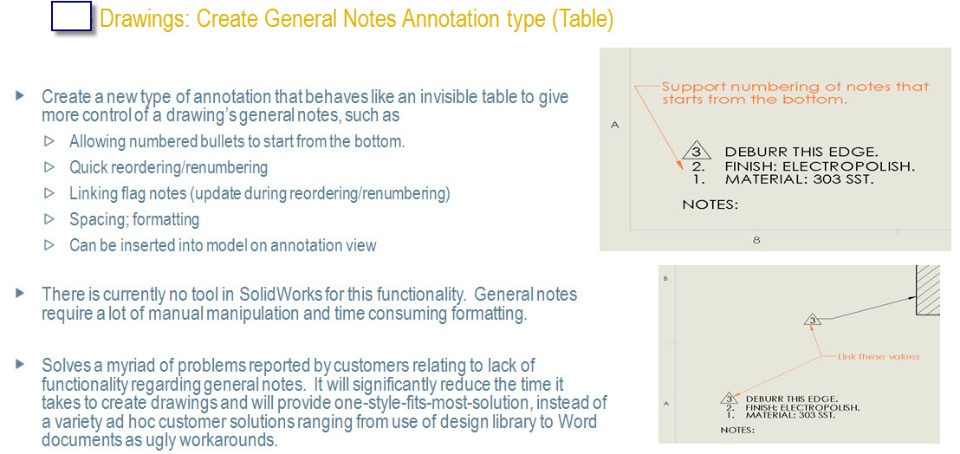

We are looking at ideas to improve drawings and speed up the creation and editing process.  This idea has come out of analyzing many customer requests around the topic of general notes:

Matt,
I like the idea of the "invisible table" to help build, arrange, and re-order lines.
I would like to see this table:
  1. have an anchor point
  2. allow ALT + Enter to get a carriage return within the cell
  3. have the ability to auto-wrap or auto-fit for text
  4. have the ability reduce cell height if font size is changed, wrapped text is removed, text is shortened, or carriage returns are removed
  5. have the ability to color/bold/underline/italicize/strikethru individual characters/words within the same cell/field
  6. have the ability to add symbols,link to other notes, or dimensions (including tolerance)
  7. have user adjustable padding on sides, top, and bottom
  8. have the ability to indent within a cell
  9. have left, center, and right justification per cell
  10. have the ability to save as a template and remember every setting a user makes when they save it
  11. have the ability to link tables on multiple sheet drawings such that the next number in the table is known and used in the table on the following sheet
  12. have the ability to update note numbers on all sheets if a new line is added to a sheet that is not the last sheet in the stack

This invisible table suggestion also came up at one of our large customers in Germany recently.  They want to stop their users embedding Excel tables and to force them to use SW native tables.  However the users like Excel because they can manage all their note formatting there, then set borders to "none" and insert the Excel table into a drawing.  End result: notes are neatly aligned and no table cell borders are visible, as shown in upper right of this drawing:
We have enhancement SPR 611930 for this.
