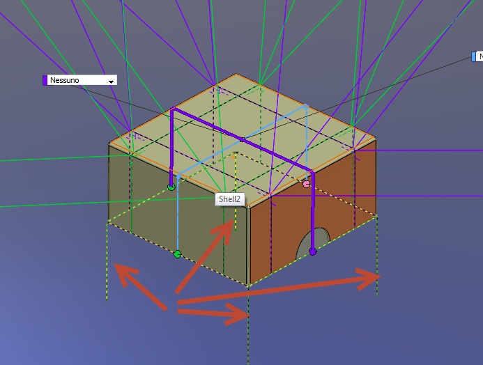

I'd like to apply a decal that spreads over all faces of a box cover.
In order to to this I'm replacing straight faces and fillets of the box with surfaces.
Original box:
I've extracted some curves and turned them to splines witg fit spline command.
I've tried various commands, and the one that seems to be quicker is boundary surface. The problem is that it won't generate the surface because it will create some spikes which will make the surface self intersecting:
I'm attaching the file. Do you have any pieces of advice in order to make this a unique surface ?

I have experience with surfacing. I think I didn't explain well my aim, sorry about that.
I need to place my decal on that cover in order that it spreads over all faces. For that i need a unique face (not surface).
If I put the decal on your surface that decal sits on only one surface and not on the fillets and the other vertical surfaces, like here:
Alex

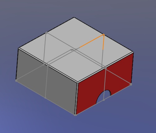

You can select multiple faces for the decal to be applied to.
comment imagecomment image
AU
AU 2013-11-25
Thanks Mark, Problem solved!
