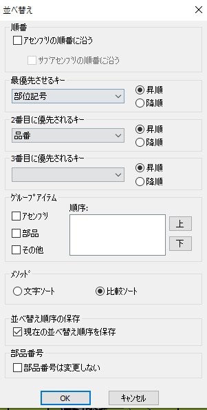

Hello.

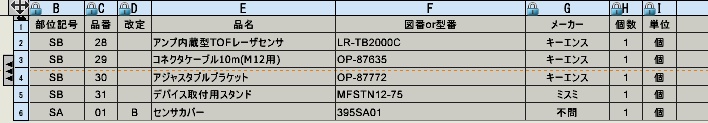

I want to sort the created BOM in ascending order in columns B and C as in the image settings, but it does not work properly.
Please help me.

'BOM SORTBOM sorting
    Dim swSortData As BomTableSortData
    Dim sortSaved As Boolean
    Set swSortData = swTableAnnotation.GetBomTableSortData
    swSortData.ColumnIndex(0) = 3
    swSortData.Ascending(0) = True
    swSortData.ColumnIndex(1) = 4
    swSortData.Ascending(1) = True
    swSortData.ColumnIndex(2) = -1
    swSortData.DoNotChangeItemNumber = False
    sortSaved = swSortData.SaveCurrentSortParameters
    boolstatus = swTableAnnotation.Sort(swSortData)
