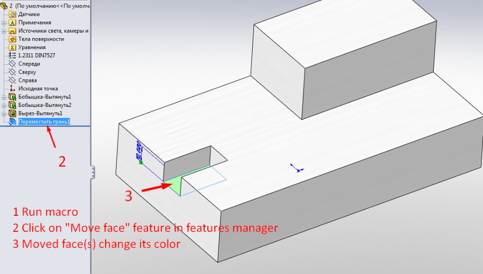

Hello all!

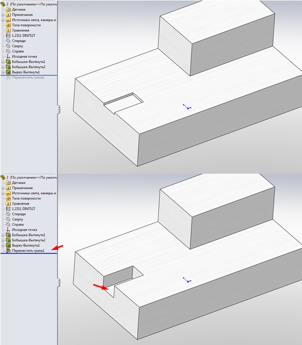

Tell me please, how can I select all faces, moved by "move face"?
I need to select and change color of faces.
I modify macro https://forum.solidworks.com/thread/88370 to change color of faces, but it works with faces of boss-extrude or cut-extrude (for example) but  doesnt work with moved faces.

Is it possible to selet these faces?
Сообщение отредактировано: Alexey Kovalov
Hello! Maybe I can I select all faces, moved by feature "move face" in future manager? Anybody know the way I can do this? Regards, Alexey
