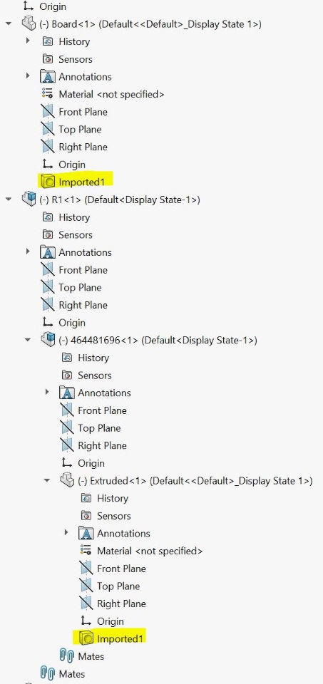

I have an issue with imported step files from Altium causing conflicts when they are put into a single assembly due to name conflicts between auto generated Imported body names, which are highlighted in the attached image. I have a macro right now that can transverse through the assembly and rename the lowest level part files with the following logic (all credit to Deepak Gupta):

I think it is the highlighted If statement that selects the sldprt files and then goes on to rename them. I can't figure out how to modify the script so it can instead stop traversing at the part and then rename (or more preferably add a suffix to the existing name) the imported parts highlighted in the attached image? If I could figure that out it would stop my ID collision issue. And unfortunately Pack-and-Go doesn't work for me because it does not actually rename everything down the hierarchy, causing the collisions to still take place.
