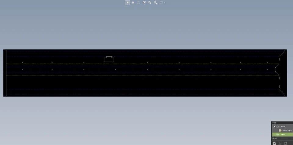

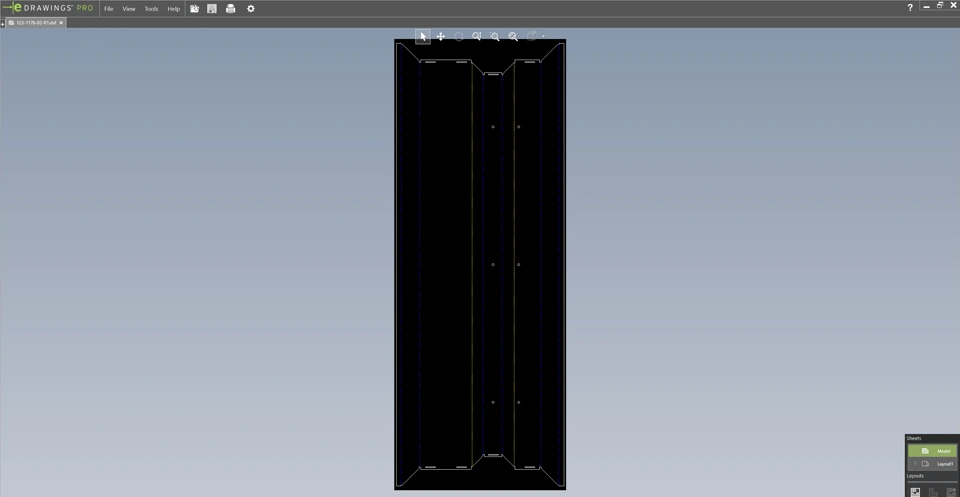

Macro to handle multibody sheetmetal dxf exports.
I am having trouble with this macro its aim is to export multibody with mapping dxfs so they all appear on the model sheet (SW usually exports the first pattern to model sheet all subsequent on Drawing View and model sheet blank). Unfortunately, my macro exports the same flat pattern(1st) to all model spaces and the correct view is still in Drawing View. Appreciate your help fixing this.
