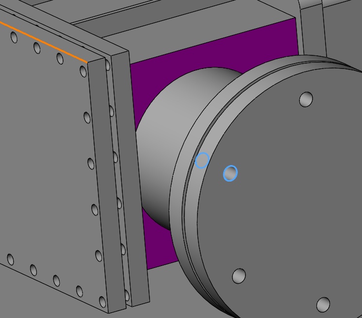

Macro to create a bolt connector using circular edges
Can anyone please explain how to create a bolt connector using macro for a flange. and what is procedure to create that flange.
and My code is

    Set Part = swApp.ActiveDoc
    Set selmgr = Part.SelectionManager
    count = selmgr.GetSelectedObjectCount
    boltcreat = False

    ReDim var(count - 1)
    For i = 0 To (count - 1)
        Set obj = selmgr.GetSelectedObject5(i + 1)
       var(i) = Part.Extension.GetPersistReference3(obj)
        Set obj = Nothing
    Next i
    For i = 0 To ((count / 2) - 1)
        Set pDisp1 = Part.Extension.GetObjectByPersistReference3((var((i * 2))), errCode)
        Set pDisp2 = Part.Extension.GetObjectByPersistReference3((var((i * 2) + 1)), errCode)
        DispArray1 = Array(pDisp1)
        DispArray2 = Array(pDisp2)

While using this code I had a problem in that red colored code that is in " var(i) "
If the count assigned in var(i) is same for both circular edges, then it will create a bolt connector
otherwise it will create a bolt connector.
Kindly help in this....
