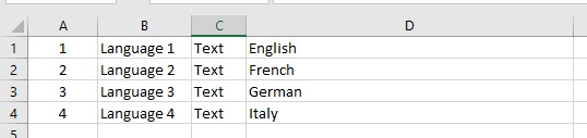

Hi,
I would like to copy the excel data to custom properties. Find out the error in my code.
Adding to this I would like to add this data for all configuration in the part.

Text1 = xlWB.Sheets(1).Cells(2, 1).Value
Text2 = xlWB.Sheets(1).Cells(4, 1).Value
swCustPropMgr.Add2 Text1, swCustomInfoText, Text2
