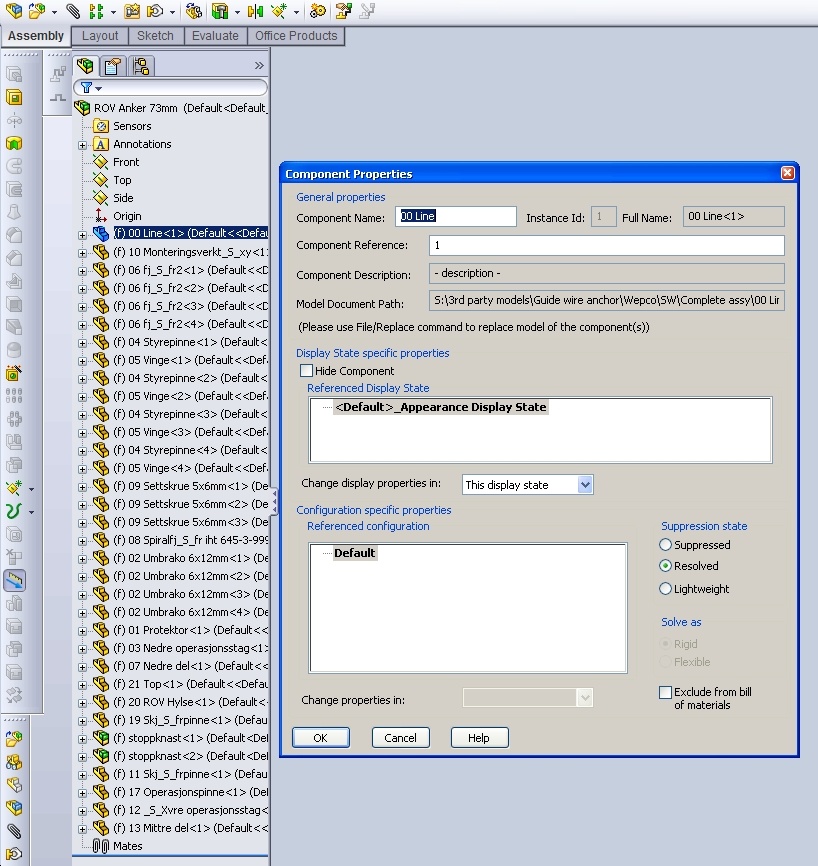

Can anyone  give me an example/explanation on how to add a value to the field Component Reference in Component Properties of a part/sub-assy in an assembly by a macro?
We are about to implement a PDM system (Teamcenter), and the cad integration uses component reference value as Pos.no in the PDM, and this will also be used in the BOM in the PDM to reflect Pos.nr on corresponding assembly drawing. Multiple instances of same part/Sub assy shall have same  Comp.Ref no.
