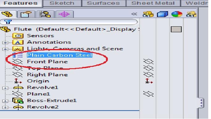

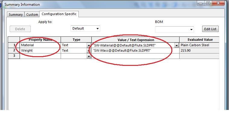

I am new in API and only able to record some simple macros. I want to assign same material and configuration spec. for all parts in part properties using macro. Can anyone  help me to create a macro to assign configuration specific and material as shown below:
Is it possible  to make changes in complete folder with single run of macro?

And also I want to assign the default material only so that I can get weight directly in File ->Properties ->Configuration specific using formula. All these properties should be assigned to the part only.
Procedure for what I want macro:
  Select a part (OR folder containing number of parts) then assign default material (Say plain carbon steel). Go to file -properties-summery information-configuration specific. Choose material in property name , text in type, Material in value from drop down menu. Do the same for Weight also. Please refer earlier attached images for more clarification.

Replace "D:\SW\" with the folder location where parts are placed. It has to changed every time you need to work on parts on different folder location. I'll add up browse location function. Make sure your path in within quotes and \ at the end of folder name (similar to the path I have in the macro)
Currently the macro will add copper as material, then add two config specific properties viz. Material and Weight but only to configuration named "Default".
If you need the macro can be edited to add config properties to active configuration.
