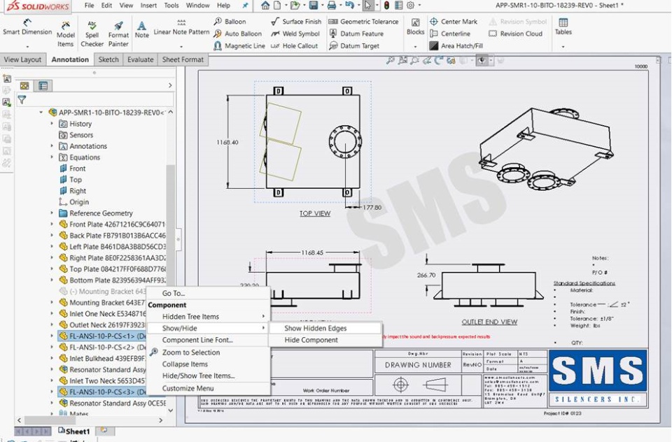

Macro Issue to make a selected Drawing View hidden component Show Hidden Edges
I am trying to make a macro which will be able to make a selected Drawing View hidden component to show hidden edges (Solidworks Snip below).
I have managed to select the required component "FL-ANSI-10-P-CS-1" with the macro shown below, but my problem is that the line:     "swDrawComp.View.SetDisplayMode3 False, swDisplayMode_e.swHIDDEN_GREYED, True, False"
is equivalent to the click of the "Hidden Lines Visible" in a Solidworks drawing for the whole selected view and not only for one required component "FL-ANSI-10-P-CS-1", which I select with the line:
     "swDrawComp.Select True, Nothing"
Thank you in advance,
I will appreciate any ideas or thoughts...

FR 2021-04-09 Best Answer
Hello, try this:
Option Explicit
Sub main()
    Dim swApp As SldWorks.SldWorks
    Dim swDraw As SldWorks.DrawingDoc
    Dim swView As SldWorks.View
    Dim swRootDrawComp As SldWorks.DrawingComponent
    Dim vDrawChildCompArr As Variant
    Dim vDrawChildComp As Variant
    Dim swDrawComp As SldWorks.DrawingComponent
    Dim swComp As SldWorks.Component2
    Set swDraw = swApp.ActiveDoc
    Set swView = swDraw.ActiveDrawingView
    Set swRootDrawComp = swView.RootDrawingComponent
    vDrawChildCompArr = swRootDrawComp.GetChildren
    For Each vDrawChildComp In vDrawChildCompArr
        Set swDrawComp = vDrawChildComp
        Set swComp = swDrawComp.Component
        If swComp.Name2 = "FL-ANSI-10-P-CS-1" Then
            swApp.RunCommand swCommands_e.swCommands_Popup_Show_Hidden, ""

PP 2021-04-09
Thank you so so much Mr Fifi Rifi!!!
It worked perfectly and did exactly what I needed,
that was a precise solution/code correction.
Greatly appreciated!!!
