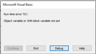

Hi all, looking for help debugging this macro which should make my job a lot easier. It's not my work, and I don't know who made it, but I'll try to help as best I can. The code below should take a part using our standard numbering scheme (basically the part number is always the same as the drawing number, unless it's a separable mechanical assembly, then the part starts with 600- and the drawing starts with 610-), and export a Parasolid and an isometric .png image, then open the associated drawing and export a PDF, all with the current revision appended to the filename.
It's getting caught on getting the revision, and I can't figure out why (I'm not a macro guy).
Any suggestions would be helpful.

Set swCustProp = swModel.Extension.CustomPropertyManager("Revision")
The word revision in the above line is configuration name. Change it to "" and this should resolves the issue because drawing doesn't have configurations.

Check the library references in the macro and make sure those are set as per your current version of SW. I have 2020 on when I made that macro.

Now your code won't even let me get past the first line

Like  said that the macro would also give error in case you won't run it with drawing as active file. So in case you want to run it from model, try the attached macro.

Try changing the code from
Set swModel <span class="" style="color: #a67f59; background: rgba(255, 255, 255, 0.5); border: 0px; font-weight: inherit;">=</span> swApp<span class="" style="color: #999999; border: 0px; font-weight: inherit;">.</span><span class="" style="color: #d74444; border: 0px; font-weight: inherit;">ActivateDoc2</span><span class="" style="color: #999999; border: 0px; font-weight: inherit;">(</span>FilePath <span class="" style="color: #a67f59; background: rgba(255, 255, 255, 0.5); border: 0px; font-weight: inherit;">&</span> PartNumber <span class="" style="color: #a67f59; background: rgba(255, 255, 255, 0.5); border: 0px; font-weight: inherit;">&</span> <span class="" style="color: #669900; border: 0px; font-weight: inherit;">".slddrw"</span><span class="" style="color: #999999; border: 0px; font-weight: inherit;">,</span> Silent<span class="" style="color: #999999; border: 0px; font-weight: inherit;">,</span> Errors<span class="" style="color: #999999; border: 0px; font-weight: inherit;">)</span><br>Dim swDrawing As Object<br>Set swDrawing <span class="" style="color: #a67f59; background: rgba(255, 255, 255, 0.5); border: 0px; font-weight: inherit;">=</span> swModel
to
Dim nErrors As Long
Dim nWarnings As Long
Set swModel = swApp.OpenDoc6(FilePath & PartNumber & ".slddrw", "", nErrors, nWarnings)
If nWarnings = 128 Then 'If warning 128 (file already opened), activate already opened file (required for drawing if not close)
Set swModel = swApp.ActivateDoc3(FilePath & PartNumber & ".slddrw", False, swRebuildOnActivation_e.swRebuildActiveDoc, nErrors)
Else 'Else activate opened file
Set swModel = swApp.ActiveDoc
End If
Set swDrawing = swModel
Hope this help...
This should open and activate the drawing
[Edit]
The code is suggested as i think it might be because the drawing it not open, hence could not be activate, leading to error afterward

Daniel Ferrucci-Herzberg wrote:
It's the same error in the original post (Runtime error 91). I can't share my screen, but if you want to test, just create any part and drawing with the same name (try 430-00119), and create custom properties for "revision" in each. Also, anywhere you see "W:\Shared With Me\Shared Documents-Goddard\Dan H ECOs" in the code, replace that with a folder on your PC.
Worked perfectly on my machine.
Your save path is not correct.
swModel.SaveAs3(StoragePath & "W:\Shared With Me\Shared Documents-Goddard\Dan H ECOs" &
it should be
swModel.SaveAs3("W:\Shared With Me\Shared Documents-Goddard\Dan H ECOs\" &

It seem to me that something is wrong with swModel? maybe from the line in red?
' Open Drawing<br><span style="color: #ff0000;">Set swModel <span class="" style="background: rgba(255, 255, 255, 0.5); border: 0px; font-weight: inherit;">=</span> swApp<span class="" style="border: 0px; font-weight: inherit;">.</span><span class="" style="border: 0px; font-weight: inherit;">ActivateDoc2</span><span class="" style="border: 0px; font-weight: inherit;">(</span>FilePath <span class="" style="background: rgba(255, 255, 255, 0.5); border: 0px; font-weight: inherit;">&</span> PartNumber <span class="" style="background: rgba(255, 255, 255, 0.5); border: 0px; font-weight: inherit;">&</span> <span class="" style="border: 0px; font-weight: inherit;">".slddrw"</span><span class="" style="border: 0px; font-weight: inherit;">,</span> Silent<span class="" style="border: 0px; font-weight: inherit;">,</span> Errors<span class="" style="border: 0px; font-weight: inherit;">)</span></span><br>Dim swDrawing As Object<br>Set swDrawing <span class="" style="color: #a67f59; background: rgba(255, 255, 255, 0.5); border: 0px; font-weight: inherit;">=</span> swModel<br><br>'Get Revision<br>Set swCustProp <span class="" style="color: #a67f59; background: rgba(255, 255, 255, 0.5); border: 0px; font-weight: inherit;">=</span> swModel<span class="" style="color: #999999; border: 0px; font-weight: inherit;">.</span>Extension<span class="" style="color: #999999; border: 0px; font-weight: inherit;">.</span><span class="" style="color: #d74444; border: 0px; font-weight: inherit;">CustomPropertyManager</span><span class="" style="color: #999999; border: 0px; font-weight: inherit;">(</span><span class="" style="color: #669900; border: 0px; font-weight: inherit;">"Revision"</span><span class="" style="color: #999999; border: 0px; font-weight: inherit;">)</span><br>bool <span class="" style="color: #a67f59; background: rgba(255, 255, 255, 0.5); border: 0px; font-weight: inherit;">=</span> swCustProp<span class="" style="color: #999999; border: 0px; font-weight: inherit;">.</span><span class="" style="color: #d74444; border: 0px; font-weight: inherit;">Get4</span><span class="" style="color: #999999; border: 0px; font-weight: inherit;">(</span><span class="" style="color: #669900; border: 0px; font-weight: inherit;">"Revision"</span><span class="" style="color: #999999; border: 0px; font-weight: inherit;">,</span> False<span class="" style="color: #999999; border: 0px; font-weight: inherit;">,</span> RevStore<span class="" style="color: #999999; border: 0px; font-weight: inherit;">,</span> ResRevStore<span class="" style="color: #999999; border: 0px; font-weight: inherit;">)</span><br>'RevStore <span class="" style="color: #a67f59; background: rgba(255, 255, 255, 0.5); border: 0px; font-weight: inherit;">=</span> swDrawing<span class="" style="color: #999999; border: 0px; font-weight: inherit;">.</span><span class="" style="color: #d74444; border: 0px; font-weight: inherit;">CustomInfo</span><span class="" style="color: #999999; border: 0px; font-weight: inherit;">(</span><span class="" style="color: #669900; border: 0px; font-weight: inherit;">"Revision"</span><span class="" style="color: #999999; border: 0px; font-weight: inherit;">)</span><br>
As a quick troubleshoot, I change it to
Set swCustProp <span class="" style="color: #a67f59; background: rgba(255, 255, 255, 0.5); border: 0px; font-weight: inherit;">=</span> swApp.ActiveDoc<span class="" style="color: #999999; border: 0px; font-weight: inherit;">.</span>Extension<span class="" style="color: #999999; border: 0px; font-weight: inherit;">.</span><span class="" style="color: #d74444; border: 0px; font-weight: inherit;">CustomPropertyManager</span><span class="" style="color: #999999; border: 0px; font-weight: inherit;">(</span><span class="" style="color: #669900; border: 0px; font-weight: inherit;">"Revision"</span><span class="" style="color: #999999; border: 0px; font-weight: inherit;">)</span>
The error then move to the lower line
which is what Deepak mention of missing configuration.
Remove the revision configuration then
Set swCustProp <span class="" style="color: #a67f59; background: rgba(255, 255, 255, 0.5); border: 0px; font-weight: inherit;">=</span> swApp.ActiveDoc<span class="" style="color: #999999; border: 0px; font-weight: inherit;">.</span>Extension<span class="" style="color: #999999; border: 0px; font-weight: inherit;">.</span><span class="" style="color: #d74444; border: 0px; font-weight: inherit;">CustomPropertyManager</span><span class="" style="color: #999999; border: 0px; font-weight: inherit;">(</span><span class="" style="color: #669900; border: 0px; font-weight: inherit;">""</span><span class="" style="color: #999999; border: 0px; font-weight: inherit;">)</span>
allow me to  go further down in the code...
From my (not so much) experience, even if you do not have the Revision configuration, the line will/should fail at
instead of
but as Deepak mentioned, you may eventually need to change it to
Set swCustProp <span class="" style="color: #a67f59; background: rgba(255, 255, 255, 0.5); border: 0px; font-weight: inherit;">=</span> swModel<span class="" style="color: #999999; border: 0px; font-weight: inherit;">.</span>Extension<span class="" style="color: #999999; border: 0px; font-weight: inherit;">.</span><span class="" style="color: #d74444; border: 0px; font-weight: inherit;">CustomPropertyManager</span><span class="" style="color: #999999; border: 0px; font-weight: inherit;">(</span><span class="" style="color: #669900; border: 0px; font-weight: inherit;">""</span><span class="" style="color: #999999; border: 0px; font-weight: inherit;">)</span><br>
to solve the missing configuration issue
Didn't help unfortunately
What error you getting? Can you show me your screen via teamviewer?
Wouldn't it make sense that I need to specify the name of the custom property (Revision) to get?
That is already done in this line
bool = swCustProp.Get4("Revision", False, RevStore, ResRevStore)
